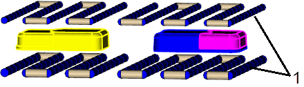

Both sides of the mold contain cooling channels. You need to distinguish the channels that belong to the fixed cavity from the ones that belong to the rotational core.
- Using the Layers pane, select the cooling channels (1).

The cooling channels(1).
