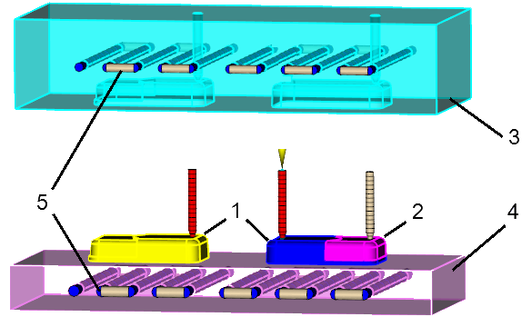

Prerequisites
This topic assumes that you have prepared one study that includes:
A meshed model of two identical first components, including their optional running systems (1).
Note: The runner system of the first component above the overmolding cavity (right part, not represented in the figure) is required for calculation purposes only. It has to be there but the mold must not take into account its geometry.A meshed model of the second component and its optional runner system (2).
The two mold cavities, represented as Fixed Cavity (3) and Rotating Core (4) in the figure below.
Note: The design of the Fixed Cavity needs to take into account the runner systems represented in the figure below only.The cooling channels (5).
