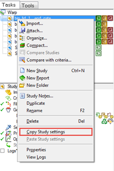

Select the original study, click the right-hand mouse button and select Copy Study settings from the context menu. Notice that the Paste Study settings option, below it, is not active at this stage.
Select the target study, click the right-hand mouse button and select Paste Study settings from the context menu, which is now active.
