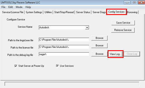

  1. Log in to the Network License Manager.
  2. From the Windows Start menu, open LMTOOLS Utility.
  3. Select the Config Services tab.
  4. Click View Log

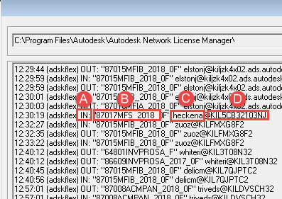

    license tracking
    to see:
    1. Whether or not the license is checked in or out
    2. Which license level and version are in use
    3. Who is using the license
    4. On which machine the license is being used.
      license log
  5. When you have finished, click Close Log to close the log.
