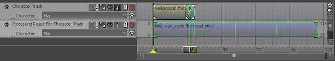

  3. Select the mia_walk_cycle.fbx clip and stretch the (end of the) mia_walk_cycle.fbx clip to frame 116.
    mia_walk_cycle.fbx clip stretched to frame 116
    The clip loops four times.

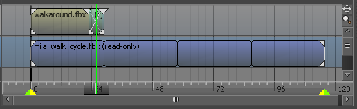

  4. In the Action Track, right-click either one of the Character Tracks (the Character Track or the Processing Result for Character Track) and choose Frame Start/End from the context menu.
    Character Track context menu
    The time range is resized to fit the length of the clip, as shown in the following figure.
