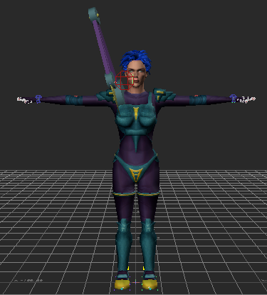

    In the Viewer window, Mia with her servo arm appears in the T-stance.
    Mia in the T-stance
