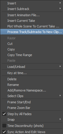

  2. In the Action Track, right-click the Character Track and choose Process Track/Subtracks to New Clip... from the context menu.

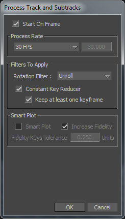

    The Process Tracks and Subtracks dialog displays.
  3. Change the Process Rate to 24 FPS and then click OK.

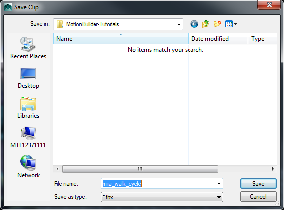

  4. In the Save Clip dialog that displays, navigate to a directory other than the default MotionBuilder Tutorials directory and save your new clip as mia_walk_cycle.fbx.
