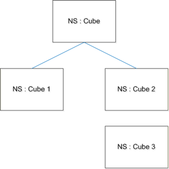

For example, if you rotate the NS:Cube and scale the NS:Cube 1 in the following scene, the changes and the file reference object are stored inside the FBX scene file when the file is saved.
The next time when this scene is opened, the file reference object is created while loading and the changes are also applied to it. You can view the reference edit by calling the GetRefEdit function on the file reference object.

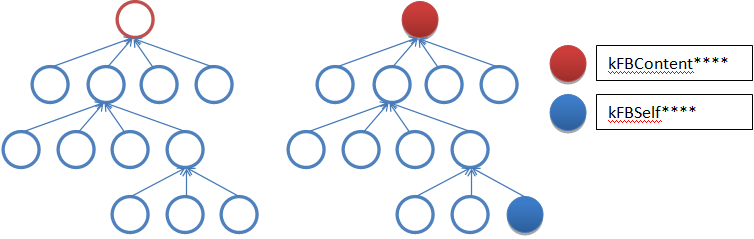

A self dirty flag is put on the item and a content dirty flag is put on the reference object whenever the referenced item changes. The following figure illustrates this concept.
The red circle represents the reference object and the blue circle represents the referenced items. The result after the dirty flags are set is shown on the right.

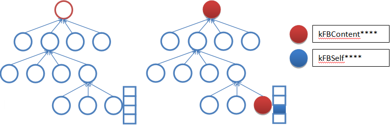

If a property of a referenced item changes, a self dirty flag is put on the property and a content dirty flag is put on the reference object. The following figure illustrates this concept. The blue boxes represent the properties of a referenced item. The result after the dirty flags are set is shown on the right.
