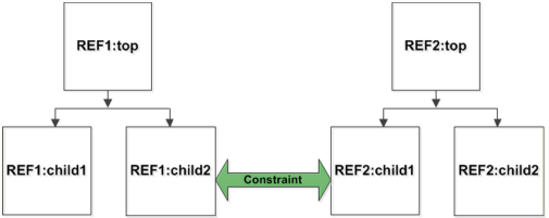

  • This figure shows an allowed constraint.

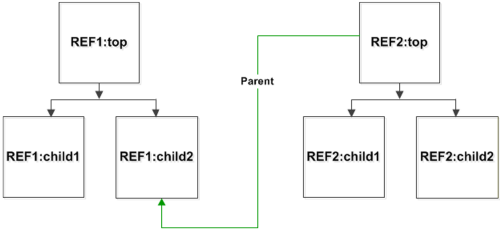

  • This figure shows an allowed parent connection.

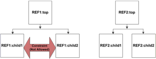

  • This figure shows a constraint that is not allowed.

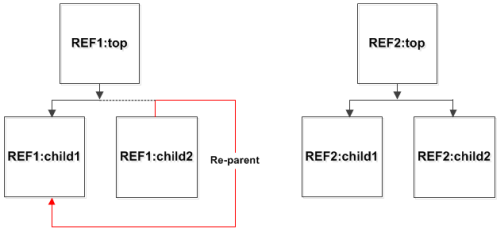

  • This figure shows a re-parent connection that is not allowed.

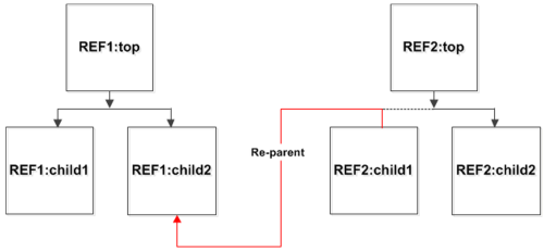

  • This figure shows another re-parent connection that is not allowed.
