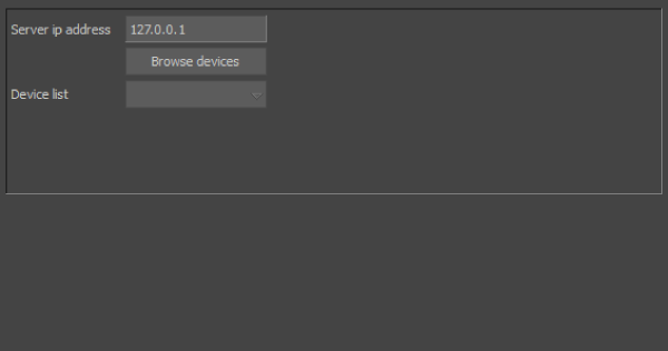

Network Client device settings
This topic explains the options in the Network Client device area and their uses.
OptionDescription
Server IP addressAddress of the machine running MotionBuilder with the Network Server device.
Browse devicesClick to view a list of all the devices added to the MotionBuilder Network Server.
Device menuClick Browse devices to list all the Network Server’s devices in this menu. Select the device to which you want to connect this Network Client.
Connect DeviceConnects the device selected in the Device menu to the Network Client.
ResetRe-establishes the connection. (Click Reset if you lose the connection.)
