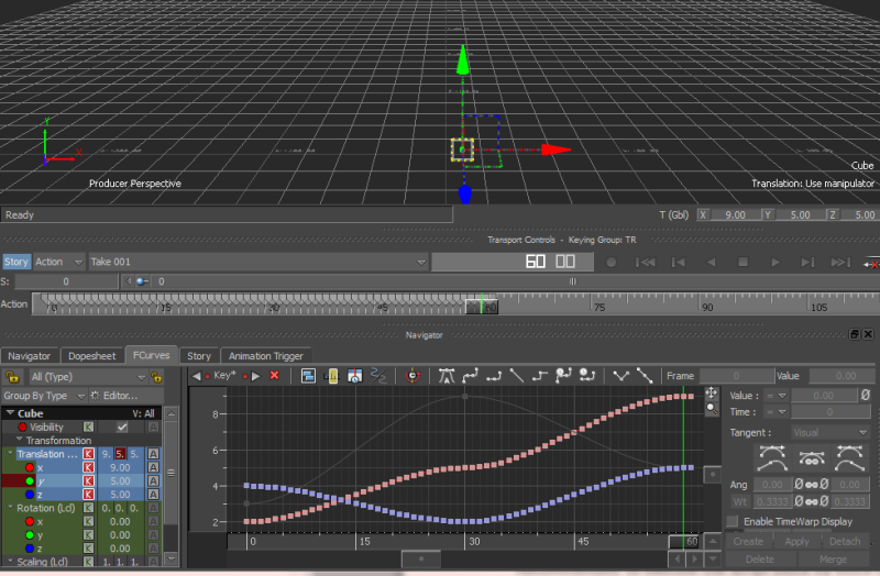

  • Run Step#1 in the script to create a scene with a cube animation and a locked channel as shown in the following figure. The locked channel y is highlighted in red color in the left panel. It appears in gray color in the FCurve view (right panel).

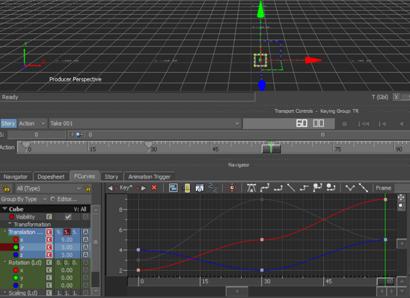

  • Run Step#2 in the script to plot everything except the locked channel as shown in the following figure.

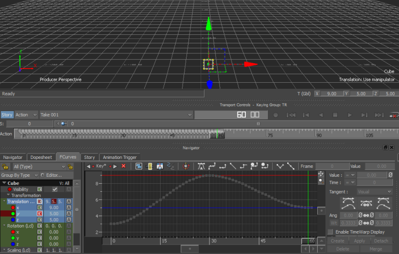

  • Run Step#3 in the script to plot everything as shown in the following figure.

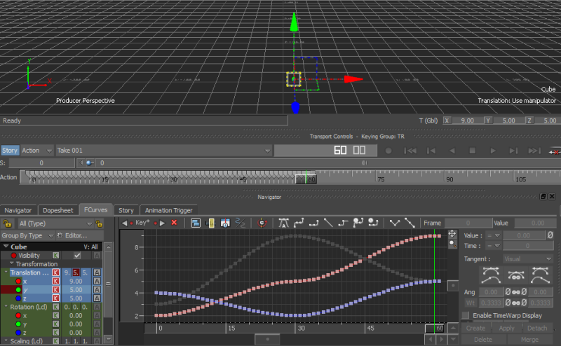

  • Run Step#4 in the script to clear all animation except the locked channel as shown in the following figure.

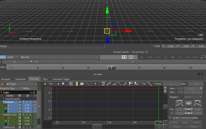

  • Run Step#5 in the script to clear all animation including the locked channel as shown in the following figure.
