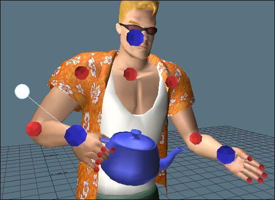

For example, you can use the handle to select a group of objects that do not have a hierarchy relationship, for example, a character’s hand model and a teapot model.
Handle attached to the character’s wrist.
This way, a Handle lets you select and manipulate a group of unrelated objects.
The second use of a Handle is that once you add a Handle to an object, it lets you create Follow objects which let you create a Parent/Child relationship that can be used as an instant transformation pivot.
With both of these uses, Handles let you quickly establish links between objects, and then use the Follow object as a pivot. See Connecting a Handle to an object.
In the image above, a Handle is attached to the model’s wrist effector and a teapot model. You can then use the Handle to move both objects together.
