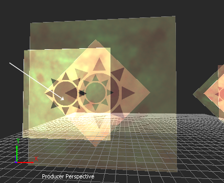

The following image shows partially transparent textured elements, all with an alpha channel. The alpha channels are the sun-shape center of the geometric elements.

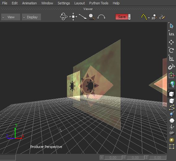

  1. In the Viewer toolbar, click the Easy Selection button () or use the keyboard shortcut Alt + Shift + A to toggle the Easy Selection button on ().
  2. In the Viewer window, click through the alpha channel of the textured geometric element in the foreground that occludes the geometric element behind it.

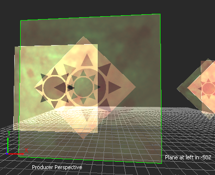

    The geometric element behind the geometric element in the foreground is shown selected as its border is highlighted.

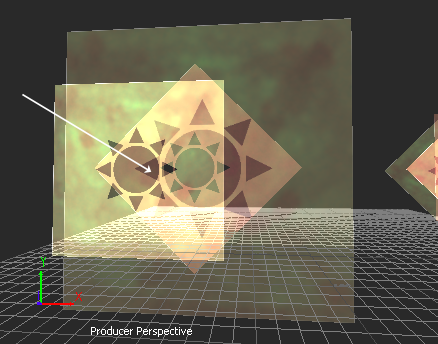

  2. In the Viewer window, click through the alpha channels of the geometric elements in the foreground that occlude the geometric element in the background.
    The geometric element in the background is shown selected as its border is highlighted.
