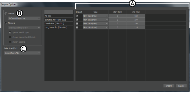

Import Options dialog box A. Import table B. Create or Merge area C. Custom import options

The Import Table
The Import table lists all the selected files for import, their start and end frames, samples, sample rate, and other options. The Import Table is the same for all data formats except scenes and .fbx files.
The top row, called All Files lets you change the value of a given column for all files at the same time. Values for each file are clamped to their absolute minimum or maximum. For example, if you enter 30000 as the sample rate, the sample rate for all files is set to this maximum.
Column | Description |
Files to Import | Lists all the selected files dragged from the Asset browser or selected using the Import File dialog box. |
Import column | Select which files to import. |
Take column | Displays the name of the take where each animation is imported. If you import to a take that already has animation, it is replaced by the take you are importing. If you want to import to a new take, select New Take from the list of takes. You can also rename the take using this field. |
Start and End | The Start and End time codes are expressed in the same time format as is shown in the Transport Controls. You can change the start and end time of each imported file to ensure, for example, that each animation starts at frame 0. |
Samples | Displays the number of samples found in each imported file. You can change the duration by changing the number of samples. |
Sampling Rate | The Sampling Rate field shows the frame rate from the imported file. Change the value in this column to speed up or slow down your animation based on the file’s original sampling rate. Select Custom to use the adjacent Custom field to enter your own frame rate. |
Custom | The Custom column lets you enter your own frame rate for the imported file. |
The options in the Create or Merge area change if you select an object before attempting to import files.
For example, if you select an object before performing File > Import, the available create and merge options change. All Create options are listed in the following table:
The Custom import options are found beneath the Create and Merge options, and lets you access additional options that depend on the file format that you are importing. This is covered in a section of its own: Custom import options.
