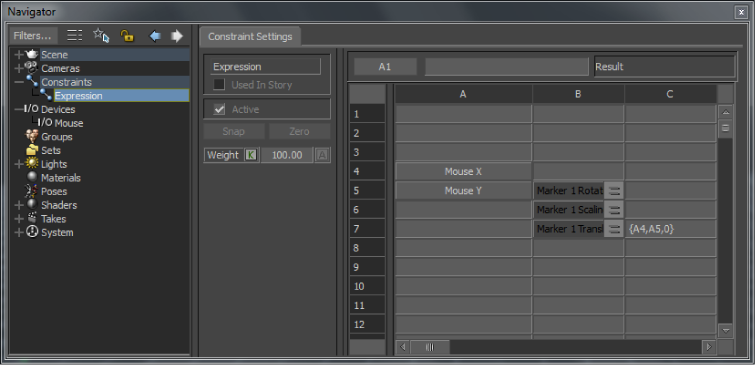

In MotionBuilder, expressions are referred to as expression constraints. Unlike Relation constraints, you use a spreadsheet-style interface to construct expression constraints. This spreadsheet interface is called the Expression Constraint Settings pane.
The Expression Constraint Settings pane lets you use a mathematical method rather than graphical method of constraining objects. This can be useful if you are familiar with commonly-used spreadsheet programs.
With an Expression constraint, you enter data in cells instead of linking them with connectors, as you do with Relation constraints. Once these elements are combined, they create an Expression constraint that can be applied to a model.
Similar to Relation constraints, the Expression constraint method is useful for complex relationships, but in this case, they are helpful for creating more mathematically-based relationships.
