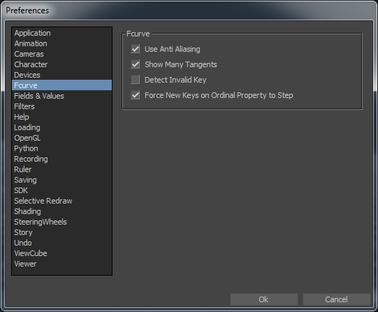

The Preferences window include the FCurves preference settings.
The FCurves preference settings include the options to use anti-aliasing and to display multiple tangents.
To access the FCurves preferences:
  1. From the menu bar, select Settings Preferences.
  2. In the Preferences window, click the FCurves preference option.
    The FCurves preference settings display.
    FCurves preferences
The following table describes the FCurves preference settings.
FCurves settings
Description
Use Anti Aliasing
When enabled, creates a visual change only, no data is affected. The default option is active.
Show Many Tangents
When enabled, displays multiple tangents.
Detect invalid key
When enabled, detects when an invalid key is inserted, and displays an error message if needed. The problematic key value is automatically reset to 0 and can be fixed manually.
Force New Keys on Ordinal Property to Step
When enabled (default), keying an ordinal property generates a Step key.
