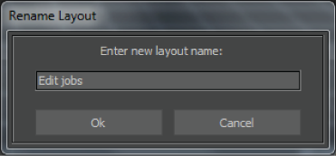

To rename the current layout:
  • Select Layout > Rename Current Layout.
    The Rename Current Layout dialog box appears, letting you rename the current layout.
    Rename Layout dialog box
Note:
You can only rename the current (or active ) layout.

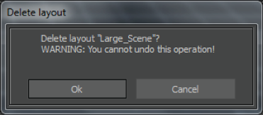

To delete a custom layout:
  1. Select Layout > Delete Layout.
    Click the custom layout you want to delete in the list that appears.
  2. A dialog box displays asking you to confirm deletion.
    Delete Layout dialog box
  3. Click Ok to delete the selected layout.
    Note:
    Be careful while deleting custom layouts. Deleting a layout cannot be undone.
    When you delete a custom layout, MotionBuilder switches to the first default layout.
