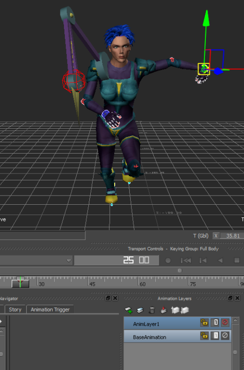

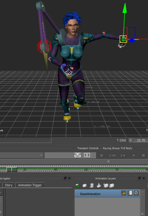

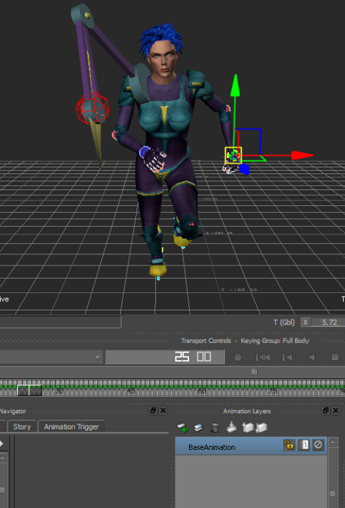

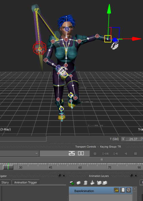

    2. Go to frame 25 (in play control). The wrist position looks as shown in the following figure.
    3. Select the left wrist effector.
    4. Change the left wrist effector's IK Blend T to 100.
    5. Modify the left wrist effector's T value.

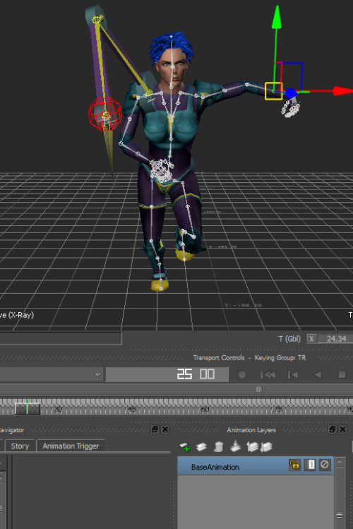

    6. Key character. The character's animation on the left wrist is changed around frame 25 by creating a new key in the new layer as shown in the following figure.

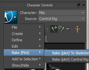

Characters can store animation in the skeleton and control rig. The skeleton and control rig have many bones (joints) that contain animation in the T, R, and S channels (also called FCurve node). The FCurve node contains the x, y, and z FCurves, which contain the keys with the value, time, and key type information. In character plotting, the keys are copied and pasted frame by frame from one FCurve to the other.
The UI option for plotting is shown in the following figure.
The FBCharacter::PlotAnimation() function is used for plotting in the SDK.

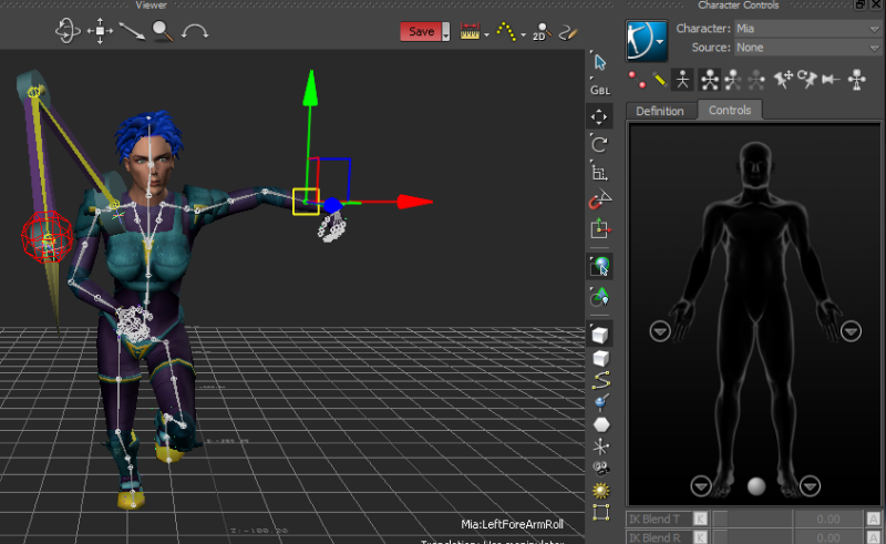

    Select a bone in the skeleton. You will not find any animation.
  2. Run the plot_character_animation_to_skeleton.py script to plot the character’s animation from the control rig to the skeleton in the current take.
    Now, you can see that the bone for the character (LeftForeArmRoll) contains animation as shown in the following figure. If you select the character's input to None (usually, the input is automatically changed to None), the character still moves when played. It indicates that the animation is plotted to the skeleton, and the character does not require any input to move.
