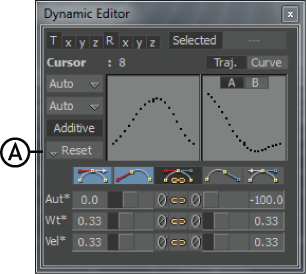

Resetting interpolation
When editing Auto and TCB interpolation with the Dynamic Editor, you can return settings to their default values using the Reset menu.
To reset Auto interpolation:
  1. Move the Timeline indicator to the animation you want to reset.
  2. In the Dynamic Editor, click Reset to open the menu and select from the following:
    • To reset values in the Auto settings to zero, select Reset Angular Parameters.
    • To reset values in the Weight settings to 0.33, select Reset Weight Parameters.
    • To reset the Velocity settings to 0.33, select Reset Velocity Parameters.
    • To reset all values in the Auto settings to zero, and reset the Weight and Velocity settings to 0.33, select Reset All Parameters.
      Dynamic Editor A. Reset menu
To reset TCB interpolation:
  2. In the Dynamic Editor, open the Reset menu and select Reset All.
    The Tension, Continuity, and Bias settings are all reset to 0.
