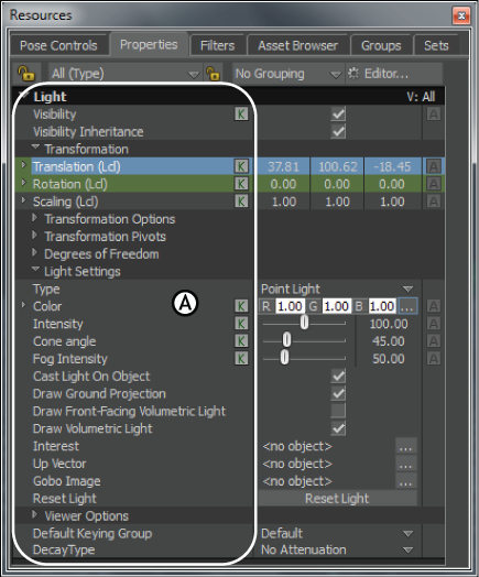

There is a Property list on the left side of the Properties, FCurves, and Dopesheet windows.
The Property list displays the property names of selected objects in a list structure. What displays also depends on which Property options are active and on which view is selected.
For example, the following figure (A) displays the properties of a selected light in the Property list.
Properties window A. Selected light’s properties
  • Properties that display in light blue are currently selected in the Key Controls window’s Keying Mode menu and can be keyframed.
  • Properties that display in dark blue represent properties that you select in the Properties, FCurves, or Dopesheet windows, and can be keyframed.
  • Properties that display in dark gray are currently selected but cannot be keyframed.

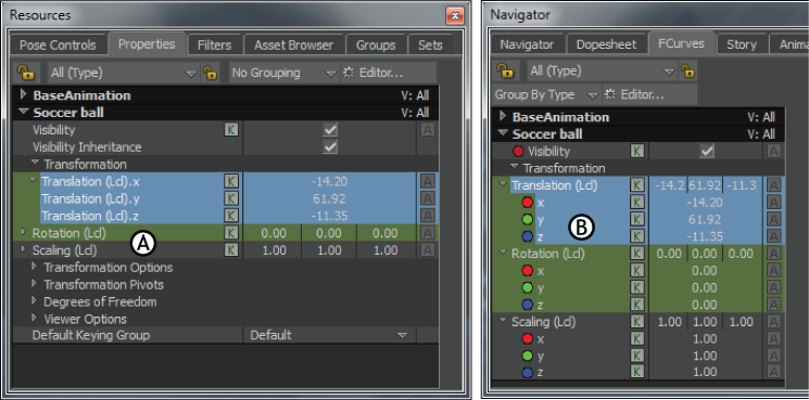

FCurves Property list
The Property list in the FCurves window displays properties differently than in the Properties window. In the Properties window, a property’s name is listed to the left of its settings.
Property lists A. Property list in the Properties window B. Property list in the FCurves window
In the FCurves window, each property with a function curve also has a Color button, which indicates the color of the property’s function curve.

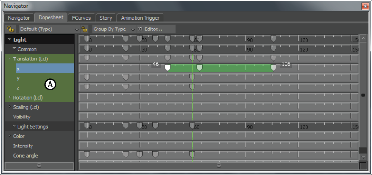

Dopesheet Property list
The Dopesheet Property list resembles the Property list in the Properties window.
By default, the properties of an object display beneath the object’s name in the list. Only the properties that you can animate display. To hide an object’s properties, collapse the list by clicking the arrow next to the object’s name.
Dopesheet window A. Dopesheet Property list
When you select an object or property in another window, such as the Properties window, the same object or property is selected in the Dopesheet Property list and the FCurves Property list.
