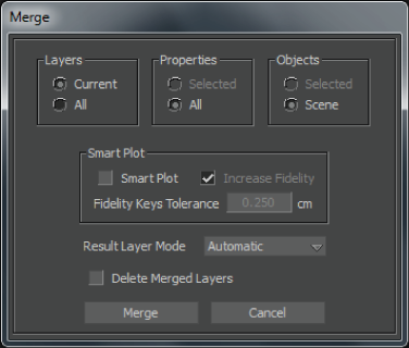

Use the Merge dialog settings to specify how you want the merge to occur. See Merge dialog box.

In the Merge dialog box that appears, set the merge options. For information on these options, see Merge dialog box.
Merge dialog box
Depending on what you selected in the Merge dialog box, the animation from the selected layers are either merged onto a new layer or to the BaseAnimation layer. All of the merged properties display with keyframes on the BaseAnimation layer.
