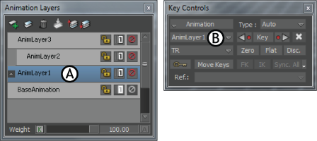

Current layer
The animation layer that receives keyframes is referred to as the current layer. The current layer displays bright green in the Animation Layer editor and is selected in the Key Controls’ Layer menu. There can only be one current layer; you can set keyframes on only one layer at the same time. See Selecting layers.
Note:
A locked layer cannot receive keyframes. See Locked layer.
Current layer A. Selected in Animation Layer editor B. Selected in Key Controls window
