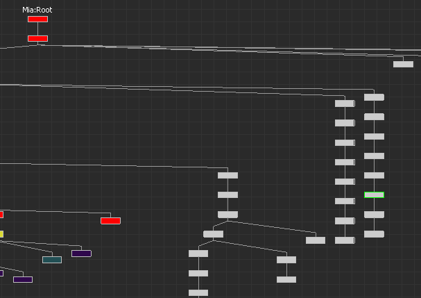

In the Viewer window, switch to the Schematic view and select the Mia:RightFoot node.
The contour of the Mia:RightFoot node is highlighted in green
This node represents Mia’s right foot and is to be used as the matching object.

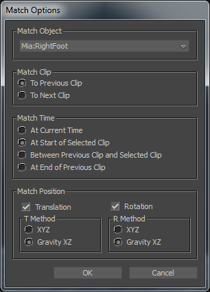

In the Story window Character Track, select the third clip (run_boom.fbx).
In the Story window controls, click the Match options
The Match Options dialog displays.
In the Match Options dialog, under Match Clip, ensure To Previous Clip is selected, and under Match Time, select Between Previous Clip and Selected Clip, then click OK.
The last clip vector moves to match the previous clip.
Click the Viewer window, and deselect the Mia:RightFoot(Shift-D).
Play the animation.
Mia runs, turns, then is thrown forward. The jump in the animation is gone.
