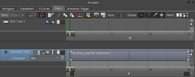

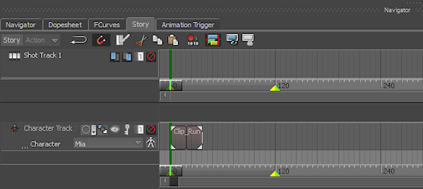

In the Navigator window, click the Story tab.
The Clip_Run_Loop is displayed in the Character Track.
Click the Character Track and press the keyboard shortcut A to frame (or zoom in on) the clip.
After framing the Clip_Run_Loop.fbx clip, the Character Track is highlighted in blue indicating it is selected, and the Clip_Run_Loop.fbx clip is no longer shown as being selected.

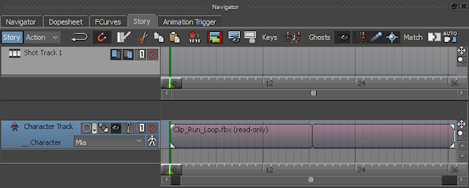

In the Story window controls, activate the Story mode option (
).When the Story mode option is activated (
), the Story window is activated and you can select either the Story Action or Story Edit mode.Note:Both of these modes are available in the Story window and in the Transport Controls window.
When the Story mode option is activated, the animation in the Story window can override or blend with the take selected in the Transport Controls window.

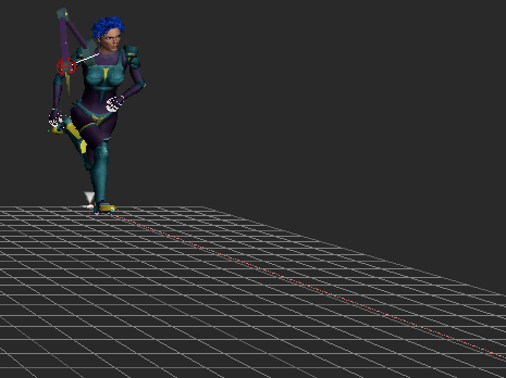

In the Viewer window, a red vector is displayed on what appears to be Mia's running path.
This vector is the clip's ghost vector. It is displayed because the Character Track's Ghost Visibility option (
) in the Character Track menu is activated.
Character Track menu shows the Ghost Visibility option activated
