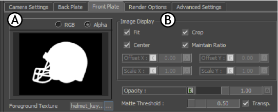

Front Plate pane
Similar to the Back Plate pane, the Front Plate pane lets you select a texture (containing either an image or video clip) to appear in the camera view, but for the camera’s foreground plane.
The Front Plate plane is a separate plane used only for projecting images or video clips. The size of the plane matches the camera’s viewing area and remains a part of the camera’s view, even with the 2D magnifier, and the Turn Table options.
Front Plate pane A. Image Preview area B. Image Display settings
Image Preview area
The Image Preview area of the Camera Settings Front Plate pane contains settings for loading a Front Plate picture, as well as lets you preview RGB or Alpha channels.
RGB - Alpha
Select either the RGB or Alpha options to preview either the RGB or Alpha channels of a loaded image.
Image preview A. RGB view B. Alpha view

Image Display area
The Image Display area lets you select how the specified texture is applied to the Front Plate plane.
The default Image Display settings are Center and Maintain Ratio.
Choose the following options from the Image Display area:
