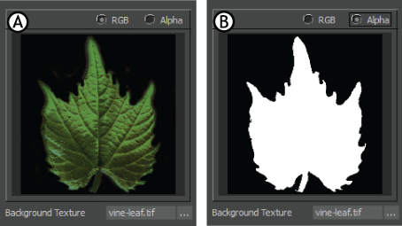

Select either the RGB or Alpha options to preview either the RGB or Alpha channels of the loaded image.
Image preview A. RGB view B. Alpha view
