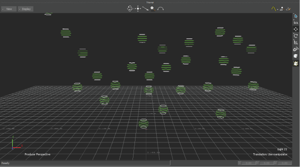

To add multiple assets to your scene:
  1. Double-click the asset in the Asset browser.
    The cursor becomes a cross hair.
    Note:
    This procedure applies only to the 3D Curve, Camera, stereoCamera, Cube, Light, Marker, Null, Optical, Plane, Skeleton node, and Skeleton root assets.
  2. Click anywhere in the Viewer window to place assets at that point.
    The Viewer window updates displaying assets being added to the scene. In the following figure, multiple lights are added.
    Viewer window displays multiple lights

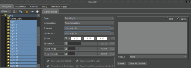

    The Navigator window updates to display settings for those assets.
    Navigator displays asset settings
