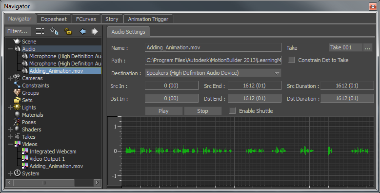

If you load a video file containing video and audio via the Asset browser and drag it to the Videos' branch in the Navigator window:
- The asset's audio is added to the Scene browser's Audio branch.
- The asset's video is added to the Scene browser's Videos' branch.
Navigator window showing file's audio settings and file's video added as video asset
To load a video asset from the Asset browser to the Navigator window Scene browser:
- In the Asset browser, drag a video asset in the Navigator window and drop it onto the Videos branch.

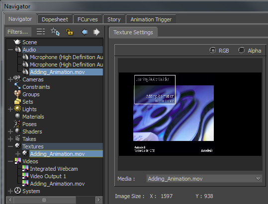

If you load a video file containing video and audio via File > Import Video, the asset's video is loaded in the Navigator window's Scene browser:
- The asset's video is added to the Scene browser's Textures' branch and Videos' branch.
Navigator window showing only file's video added as video asset and video texture
If you load a video file containing video and audio via the Scene browser's Videos branch, the asset's video is loaded in the Navigator (window) Scene browser:

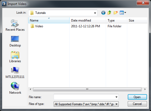

To add a video asset to the scene via File
Import Video:
Select File
Import Video.
Tip:In the Import Video dialog, click the Files of type field to find out which file formats are supported.
In the Import Video dialog, navigate to the location where your file resides.
Select the file and click Open.

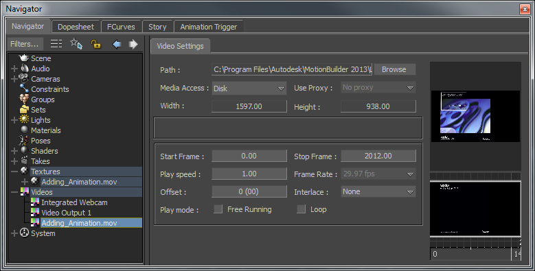

The asset's video is added to the Scene browser's Textures' branch and Videos' branch and the asset's settings are displayed in the Navigator window's Video Settings' tab.

The asset's video is added to the Scene browser's Textures' branch and Videos' branch and the asset's settings are displayed in the Navigator window Video Settings pane.
