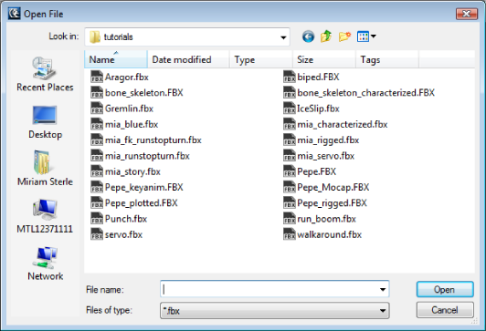

  1. Select File > Open from the MotionBuilder menu bar. The Open File browser appears.
![](images/2011_w_OpenFile.png)
Open File browser
  1. Using the File browser, select the file containing the assets you want to load and click Open.

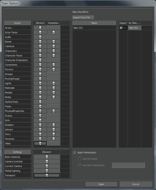

The Open Options dialog appears.
![](images/2011_w_OpenOptions.png)
Open Options dialog box
>Note: You can resize the Open Options dialog box.
The Open Options dialog box consists of the following areas:
-    [Assets area](topicid=GUID-194016BF-4BF0-4434-B79E-4BD035B8DCAD#GUID-194016BF-4BF0-4434-B79E-4BD035B8DCAD__WS1A9193826455F5FF-54F556CA1166AC9EE9E-577A)
-    [Takes area](topicid=GUID-194016BF-4BF0-4434-B79E-4BD035B8DCAD#GUID-194016BF-4BF0-4434-B79E-4BD035B8DCAD__WSF00FE1F65A1E03F9330E027211688C438A3-7FF8)
-    [Settings area](topicid=GUID-194016BF-4BF0-4434-B79E-4BD035B8DCAD#GUID-194016BF-4BF0-4434-B79E-4BD035B8DCAD__WSF00FE1F65A1E03F9330E027211688C438A3-7FF9)
-    [Namespace area](topicid=GUID-194016BF-4BF0-4434-B79E-4BD035B8DCAD#GUID-194016BF-4BF0-4434-B79E-4BD035B8DCAD__WS1A9193826455F5FF-414E5ED12075B5C5DC-7C05)
  1. Disable any elements of the file you do not want to load with the file.
  2. Activate Apply Namespace if you want to prepend a namespace to objects included in the incoming file.
  3. Click Open to open the selected .fbx file and load the selected assets, settings, and takes.
