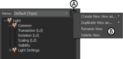

The View Options button opens a menu which contains options that let you create, duplicate, rename, and delete views.
View Editor pane A. View Options button B. View Options menu
Create New View as
Lets you create a new custom view. You can create three kinds of views. The following table describes the three different kinds of views you can create or duplicate:
Local ViewLets you create or duplicate a custom view only for the selected object.
Object Type ViewLets you create or duplicate a custom view for the type of object that is selected. For example, if you create a custom view for a Light1, all lights you select have the same view.
Global ViewLets you create or duplicate a custom view for all objects. For example, if you create a custom view for Light1, the same view can be used for a selected cube.
Duplicate View as
Duplicates the view selected in the View menu.
Rename View
Lets you rename the custom view selected in the View menu.
Delete View
Deletes the custom view selected in the View menu.
