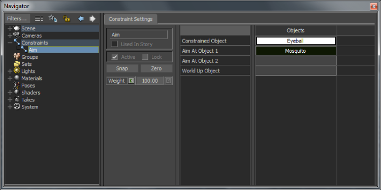

The Aim constraint requires the following objects:
Constrained object
An asset, model, or other object whose orientation derives from the Aim At Object(s) position. Also known as the “child” object.
Aim at object(s)
Object from which the position of the constrained object is derived. You can have multiple Aim At objects for this constraint.
World Up object
Lets you select an asset, model, or other object whose orientation defines the Up rotation for the object.
It is not necessary to specify a World Up Object for the Aim constraint to function.
