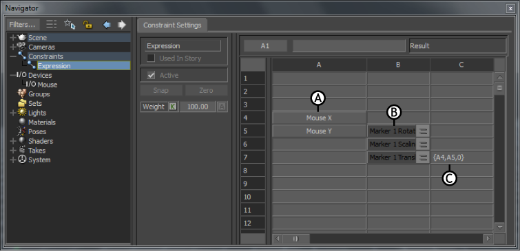

Expression constraint A. Sender Cells B. Receiver Cells C. Expression

An Expression is comprised of at least three cells. One cell contains a reference to a Sender while the other two cells are split into a Receiver cell and a mathematical expression cell.

An Expression constraint consists of at least three cells. One cell contains a reference to a Sender while the other two cells are split into a Receiver cell and a mathematical expression.

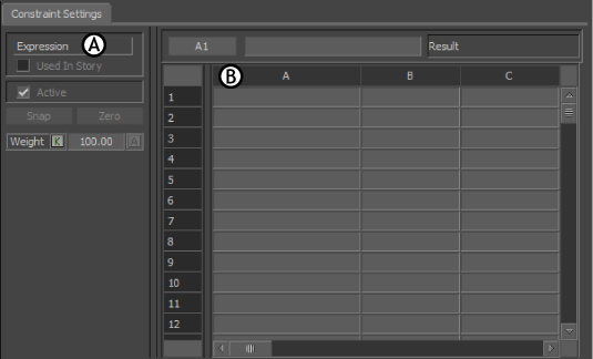

The cell sending the data can refer to an input device such as a mouse device, and the object receiving data can be a model, light, or an output device. For example, the figure below shows a mouse mapped to a marker in the Expressions pane.
Expression constraint A. Objects area B. Expression Constraint Settings pane
Between the Sender and Receiver, a mathematical expression is used to convert the numerical data from the X and Y mouse values to a vector.
You can use an unlimited amount of mathematical expressions between the Sender cell and the Receiver cell.
