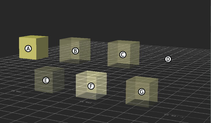

A. No Transparency B. Accurate Transparency C. Translucent D. Matte E. 2D Transparency F. Additive Transparency G. Translucent (Z Sort Models)
