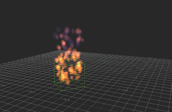

After you apply or append the Particle shader to an object, you can change the shader’s settings. The Particle shader updates in real time, which lets you fine-tune the particle settings while watching how it affects your objects. An example of a Particle shader applied to a cube is shown in the following image.
Cube with Particle shader applied
