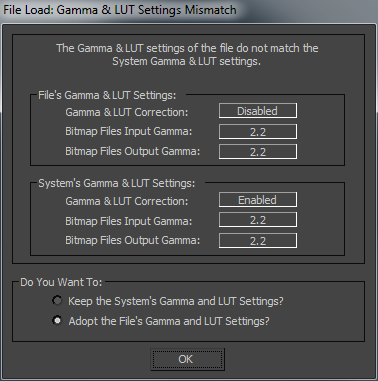

The File Load: Gamma & LUT Settings Mismatch dialog appears.
Select Adopt the File’s Gamma and LUT Settings and click OK.

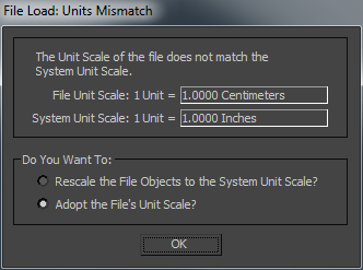

If the File Load: Unit Mismatch dialog appears, proceed to the next step. If this dialog does not appear, skip the next step.
File Load: Units Mismatch
Select the Adopt the File’s Unit Scale and click OK.

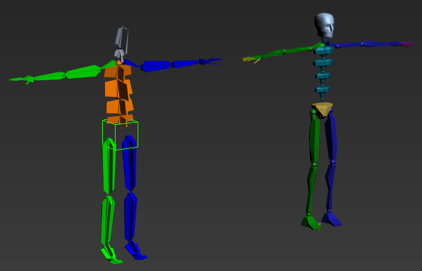

The 3ds Max scene loads, displaying two skeletons. The skeleton to the left is created with the conventional 3ds Max bone system, and the skeleton to the right is created with the 3ds Max Biped creation option.
Conventional 3ds Max bone system skeleton and 3ds Max biped
The skeleton and biped are positioned in a “T” stance, the pose used by animators for skinning.

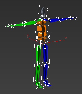

Drag across the (3ds Max bone system) skeleton to the left to region-select the skeleton.
3ds Max skeleton positioned in a T-stance

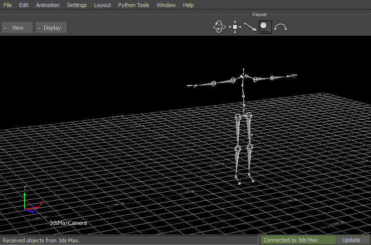

Send as New Scene.The 3ds Max scene (bone system skeleton and camera) loads into MotionBuilder.
3ds Max skeleton displayed in the Viewer window
The established connection between 3ds Max and MotionBuilder is indicated in Viewer window status bar (
).Save the scene as bone_skeleton.fbx.
