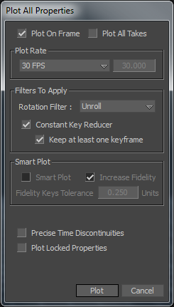

  1. Right-click anywhere in the Action Track list.
  2. Select Plot Whole Scene To Current Take in the context menu.
![](../images/2014_w-PlotAllProperties-Story.png)
  1. Select plotting options in the Plot Properties window that appears, then click Plot.
The animation is merged with the current take.
