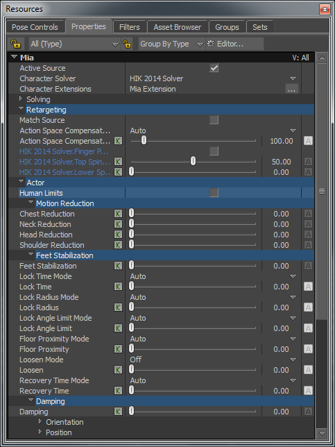

In the Retargeting group of properties within the Character Settings, the Actor properties can adjust a character’s Actor input source.
The Retargeting Actor type settings include:
  • Human Limits property setting
  • Motion Reduction property settings
  • Feet Stabilization property settings
  • Damping property settings
Retargeting Actor type property settings
Human Limits property setting prevents a character from bending a body part in an unrealistic way, while still reaching with its hands and feet.
The Feet Stabilization property settings enable you to stabilize the feet of your model. This may be necessary in certain situations, such as when you have data with noise that causes your model’s feet to jitter.
The Feet Stabilization property settings are described in the following table.
Description
Feet Stabilization
Enables you to stabilize the feet of your model.
Lock Time Mode
When set to Off, Lock Time is disabled. When set to User, you can manually specify the number of frames for the Lock Time. By default, Auto mode is selected, and Lock Time calculates the number of frames automatically.
Lock Time
Sets the feet to stationary after a specified number of frames, where the feet have not moved outside the specified range (Lock Radius and Lock Angle Limit).
Lock Radius Mode
When set to Off, Lock Radius is disabled. User mode lets you change the Lock Radius property manually. Auto mode is selected by default, and automatically calculates the Lock Radius.
Lock Radius
Sets the radius tolerance before foot stabilization is unlocked.
Lock Angle Limit Mode
When set to Off, Lock Angle Limit is disabled. Selecting User mode lets you manually adjust the angle tolerance. Auto mode calculates the angle tolerance for you, and is the default option.
Lock Angle Limit
Sets the angle tolerance before foot stabilization is unlocked.
Floor Proximity Mode
When set to Off, this mode is disabled. Selecting User mode lets you manually adjust the proximity of the feet of the character to the floor. Auto mode calculates the proximity for you, and is the default option.
Floor Proximity
Lets you adjust the proximity of the feet of the character to the floor.
Loosen Mode
When set to Off, the Loosen property is disabled. The User mode lets you manually adjust the Loosen property. By default, Auto mode is selected, automatically setting the Loosen property.
Loosen
Loosens the effect of stabilization, resulting in a less rigid effect.
Recovery Time Mode
When set to Off, the Recovery Time property is disabled. By default, Auto mode is selected, which automatically calculates the Recovery Time. Select User mode to define a customized Recovery Time.
Recovery Time
Sets the number of frames to move the foot to a new position after unlocking stabilization.
