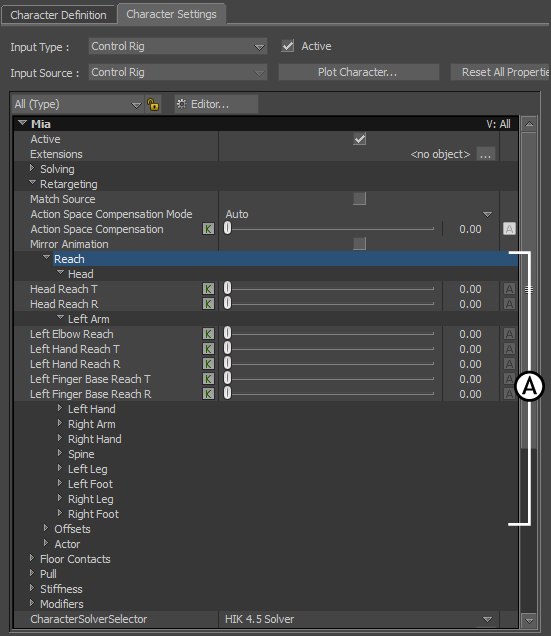

Reach
The Reach settings let you specify the percentage you want each specific bone on the skeleton of your character to reach toward its motion source. Use the Reach settings when the source of your character is either an Actor or another character.
Character Settings pane A. Retargeting > Reach settings
Almost all Reach T and Reach R settings are also accessible from the Character Controls window. Reach is different when your character’s source is set to Control Rig In. See Blend and Pull controls for more information.
To control the amount of reach, drag the setting’s slider, or type a value in the numerical field. Use the following guidelines when manipulating reach with the sliders:
- At 100%, the body part of a character reaches fully toward the body part of the source.
- At 50%, the body part of a character averages between the body part of the source and the position of a character.
- At 0%, the effect on the specified body part of the model is the same as disabling the option.

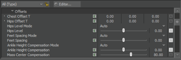

Offsets
Lets you offset the body parts of your character.
Retargeting > Offsets settings
Setting | Function |
Chest/Hips Offset T | Lets you precisely apply and adjust offsets to the chest and hips. For the offset to affect the chest, the Reach Chest option must be set to any value other than 0. |
Hips Level Mode | When set to Off, Hips Level is disabled. When set to User, you can manually adjust the level of the hips by changing the value of the Hips Level. When set to Auto, Hips Level is automatic. By default, the Hips Level Mode is set to Auto. |
Hips Level | Lets you control the level of the hips relative to its center of gravity. You can select User, Off, and Auto options from the Hips Level Mode menu. |
Feet Spacing Mode | When set to Off, Feet Spacing is disabled. When set to User, you can manually adjust the spacing of the feet. When set to Auto, the Feet Spacing is automatic. By default, the Feet Spacing Mode is set to Auto. |
Feet Spacing | Lets you adjust the amount of spacing between the feet of the model relative to the spacing between the feet of the source. |
Ankle Height Compensation Mode | When set to Off, Ankle Height Compensation is disabled. When set to User, you can adjust the distance between the feet of the model and the floor manually. By default, Auto mode ensures the feet relate correctly to the floor. |
Ankle Height Compensation | If the scale of your model and the selected source differ, use Ankle Height Compensation to adjust the distance between the model’s foot and the floor. You may also have to adjust this option if the feet of your model are large, or if your model has special height requirements (for example, shoes with high heels or boots). |
Mass Center Compensation | Smooths leg movements by preventing the hips of a character from pulling down too quickly when the legs are moving, and by preventing heavy footfalls. |
