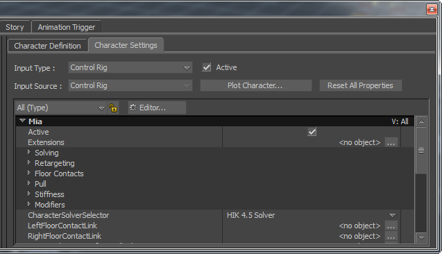

Character Settings pane
This pane lets you adjust character mapping between a selected data source and your characterized character.
Input Type
Lets you select the type of motion source you want to drive your character. After selecting the input type, select the specific source from the Input Source menu.
You can also select an input type from the Source drop-down list in the Character Controls window. See Source drop-down list for more information.

Input Source
Lets you choose the specific motion source you want to drive your character.
Active option
Turning on this option enables the link between your model and the input type and source. Once active, you can use the options in the Character Properties area to adjust how your character reacts to the input source.
Active also enables the Control rig and lets you use the Character Controls window to begin animating your character.

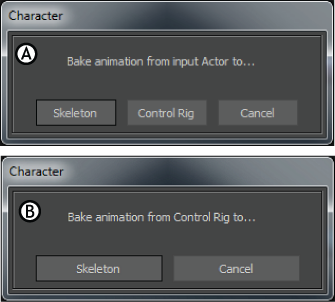

Plot Character
Transfers animation from the selected input source to your model skeleton or Control rig.
Depending on what you select as the input type and source, the Character dialog box that appears when you click Plot Character preovides different options.
For example, in the following figure, the first dialog box (A) displays when your input source is an Actor and the second dialog box (B) displays if your input source is a Control rig. When your input source is an Actor or another character, you can also plot directly to your model skeleton.
Character dialog box A. Actor input source B. Control rig input source
Reset All Properties
Lets you reset all the mapping options in the Character settings pane to their default values. You can choose to reset all solving and definition properties, only solving properties, or only definition properties.
Solving properties include Pull, Resist, Reach, and Stiffness, while Definition properties include Hand Contact Positions and Feet Contact Positions.
Lets you browse and adjust all of the properties associated with a selected character. You can change how your character reacts to the input source, how the Control rig behaves, whether floor contact for hands and feet are active, and many other properties.

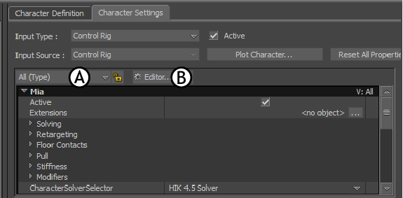

There are seven Property views that list the same options as the Default view. Each view is organized to make it easier to find certain properties. For example, the Pull view only lists properties that pertain to effector pulling in the Control rig.
Use the Select Property View drop-down list to select the view containing properties you want to work with. You can also click the Editor button to start creating your own view.
Character Settings pane A. Select Property View drop-down list B. Editor button
