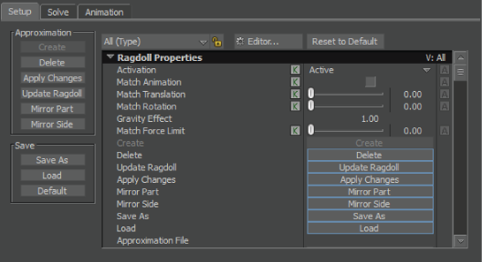

Ragdoll Setup pane
The Ragdoll Setup pane is where you configure options that are generic settings, or system overrides.
The Setup pane includes the Approximation options, Save options, and the property settings
The Ragdoll Property options display along the top of the Ragdoll Setup pane. These Property options are the View menu and Lock option, the Editor button, and the Reset to Default button to restore the Ragdoll properties to their original settings.
The Ragdoll Approximation and Save options let you create a proxy or a “Dummy” for your character. It includes the Approximation menu and the Save menu.
Approximation menu
| Option | Function |
| Create | Generates a proxy model. |
| Delete | Deletes the proxy model. |
| Apply Changes | Applies current changes to the Ragdoll proxy model information, such as changes to color, size, mass, and so on. |
| Update Ragdoll | Updates the approximation to match the character pose when it has been transformed into a different position. |
| Mirror Part | Mirrors a body part to the other side, or mirror the entire side. |
| Mirror Side | Mirrors a side of the character body to other side. |
See Creating a Ragdoll Approximation for more.
Save menu
Use these options to create a text file that contains any modifications made to the current solve.
| Option | Function |
| Save as | Save the current modifications as a text file. |
| Load | Lets you open a previously saved set of solve modifications. |
| Default | Sets the current settings as the default in the current Config file (DefaultRagdoll.txt) so that any time you click Reset to Default, the properties are reset to this state. |

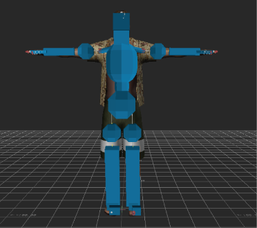

Manually adjusting the Ragdoll approximation

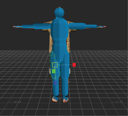

Since the Ragdoll approximation is generic creation, you can achieve better results if you customize it. You can select and transform the Ragdoll approximation components to create a better fit for your character. This can be especially useful when you work with pose matching.
Scaling a thigh approximation component

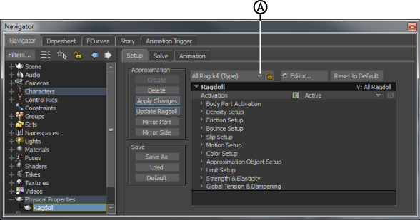

The All Ragdoll (Type) settings let you configure the settings for the solve.
Ragdoll Setup pane A. All Ragdoll (Type)
Expand each heading to expose a list of properties for body parts on which you can set custom levels for your solve.
Certain body-part settings only appear when you change the Ragdoll View menu to All Ragdoll (Type) or a specific body part view (for example, Right Foot). The following is a list of options available when All Ragdoll (Type) is selected in the View menu (A) and when there is an approximation in the scene. Otherwise, the description of the settings states which Ragdoll view to use.

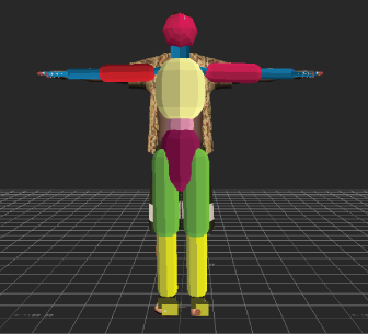

Color Setup
Expand Color Setup to expose a list of body parts on which you can set different colors for the Ragdoll approximation. This way you can single out body parts to observe during the solve.
Ragdoll approximation with custom coloring

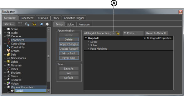

The All Ragdoll Properties (Type) settings let you configure the settings for the Setup, Solve, and Pose Matching.
Ragdoll Setup pane A. All Ragdoll Properties (Type)
