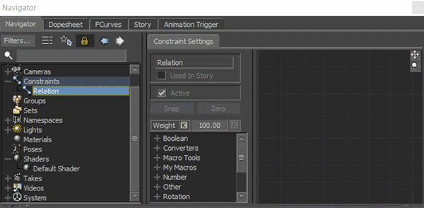

  2. Drag a Relations constraint asset from the Asset browser into the Viewer window.
    The Navigator window displays the Constraint settings, and the constraint is added to the Scene browser.
  3. From the Navigator window, expand the Constraint Takes folder, and drag the Animation Layer into the Relations constraint.
    You can only add Animation Layers to a Relations constraint through the Takes folder in the Navigator window. You cannot drag layers from the Animation Layer editor into the Relations pane.
