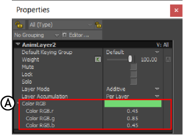

All of an animation layer’s properties that are available in the Animation Layer editor also display in the Properties window when a layer is selected. Additionally, the Properties window displays the Color RGB property.
You can open the Properties window by selecting Window > Add Property View from the main menu bar. See Properties window.
Properties window A. Color RGB property
Color RGB
Use the Color RGB settings to change the Animation layer color hint that appears in the Animation Layer Editor, Transport Controls and Story window.
