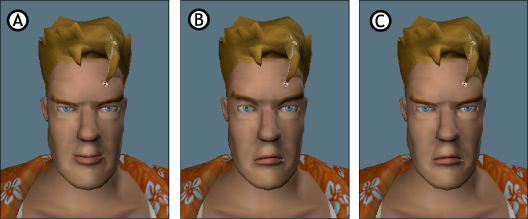

For example, you can blend the “Brow Down” shapes with the “Mouth Corner Down” shapes to create an angry facial expression on the model, as shown in the following figure.
A. Brow Down shapes B. Mouth Corner Down shapes C. Resulting angry expression
