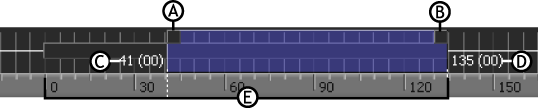

By default, cuts have the same length as the track’s take, which is represented by the blue bar on each track. There are two ways to change the length of your selected cut:
  • Drag the Start and End Cut handles (A and B).
  • Double-click the Start and End Cut time codes to enter a specific number (C and D).
    A. Start Cut handle B. End Cut handle C. Start Cut time code D. End Cut time code E. Blue bar representing the length of the take

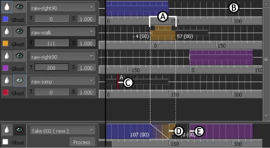

A standard blend is created when two cuts partly overlap, creating an area where the animation of both cuts is mixed. Blends appear in the Result track.
A. A cut B. White line representing the blending object C. A pose D. A blend E. A gap where interpolation occurs
Interpolation occurs in a gap between two cuts in the Result track. The data in the space between the cuts is interpolated from the last position of a cut to the first position of the next cut.
