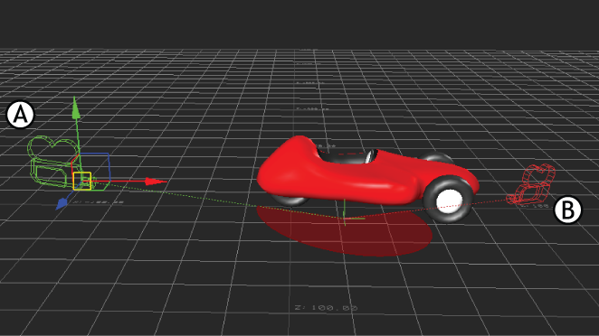

The Turn Table is useful if you want to rotate around the camera’s interest but do not want to alter the camera’s primary position. The Turn Table values maintain any Back Plate settings specific to the camera.
Camera Turn Table set to 216. A. Camera in its original position B. Camera at 321 degrees
