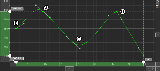

Tangents with an angle of 0 are flat. In the FCurves window, flat tangents display as completely horizontal. Flat tangents keep the interpolation from overshooting or undershooting the keyframe.
FCurves pane A. A keyframe with flat tangents. B. A keyframe with one flat tangent. C. A keyframe without flat tangents
While you can always drag tangents so that they are horizontal, you can create flat tangents more quickly. You can set keyframes with flat tangents using the Flat button in the Key Controls window. You can choose to set keyframes using Auto interpolation in Progressive Clamp mode, which flattens the tangents of keyframes when neighboring keyframes contain nearly the same value. You can also select a keyframe, then click one of the Flat buttons in the Tangent area of the FCurves window or the Flat Left and Flat Right buttons in the Auto interpolation settings of the Dynamic Editor.

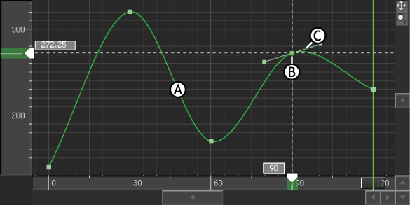

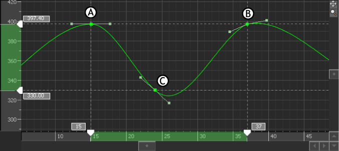

Discontinuous tangents point directly to the next or previous keyframe.
You can set a keyframe with discontinuous tangents by clicking the Discontinuity (Disc.) button in Key Controls. You can also select a keyframe, then click one of the Discontinuity buttons in the FCurves window Tangent area or the Discontinuity Left and Right buttons in the Dynamic Editor Auto interpolation settings.

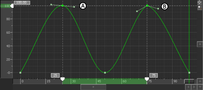

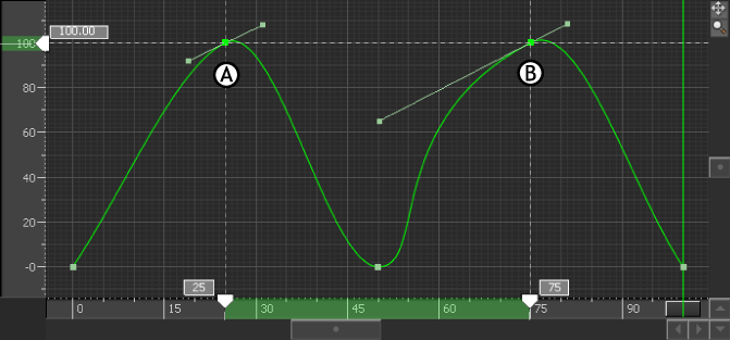

You can alter the arc of a curve by stretching or shortening tangents. This is called weighting. Weighting tangents allows you to create curves that you cannot create by simply changing the angle of tangents. See Weight settings for more information.
