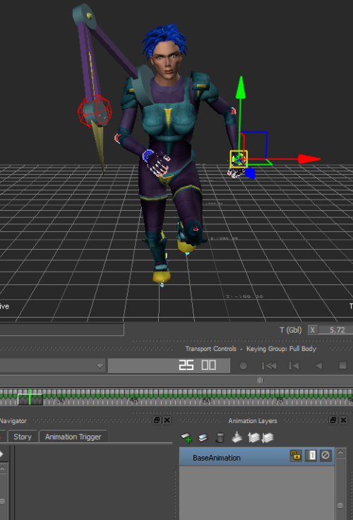

  2. Run the following steps in the manipulate_ik.py script one by one. 1. Create a new layer. 2. Go to frame 25 (in play control). The wrist position looks as shown in the following figure.
3.    Select the left wrist effector.
4.    Change the left wrist effector's IK Blend T to 100.
5.    Modify the left wrist effector's T value.
6.    Key character. The character's animation on the left wrist is changed around frame 25 by creating a new key in the new layer as shown in the following figure.

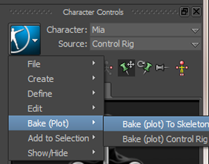

Plotting Animation from the Control Rig to the Skeleton
Characters can store animation in the skeleton and control rig. The skeleton and control rig have many bones (joints) that contain animation in the T, R, and S channels (also called FCurve node). The FCurve node contains the x, y, and z FCurves, which contain the keys with the value, time, and key type information. In character plotting, the keys are copied and pasted frame by frame from one FCurve to the other.
The UI option for plotting is shown in the following figure.
The FBCharacter::PlotAnimation() function is used for plotting in the SDK.
