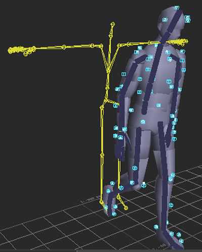

  1. Create a skeleton from the actor. CreateSkeletonForActor(pActor,pPrefix) creates a skeleton as shown in the following figure.
![](../../images/createskeleton.png)
