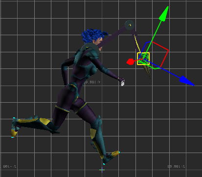

  1. Go to frame 24.
    At this frame, Mia’s head points straight ahead. You need to modify the motion so that Mia turns her head.
    Mia at frame 24

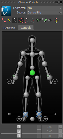

  3. In the the Character Controls window, switch to Body Part keying mode and select the Head effector.
    • Go to the Character Controls window.
      Notice the keying mode is set to Full Body ( ).
    • Click the Body Part ( ) keying mode.
      The change to the keying mode is also reflected in the Key Controls window.
    • Click the Head effector.
    Keying mode set to Body Part and Head effector selected
    You set the keying mode to Body Part as you only need to set keyframes on the head and not the entire body.

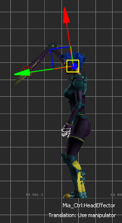

  5. Go to frame 200 and set a Zero keyframe.
    Mia at frame 200 with Head effector selected

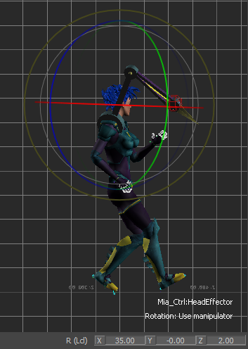

  6. Go to frame 48 and do the following:
    • In the Viewer window toolbar, click the Rotate tool ( ).
    • At the bottom right of the Viewer window, in the Global/Local Reference fields, set the XYZ Rotation values to 35 (in X), 0 (in Y), and 2 (in Z).
      Frame 48: Mia's head rotated at 35 (in X), 0 (in Y), and 2 (in Z)
    • In the Key Controls window, click to set a keyframe.

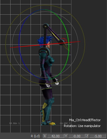

  7. Go to frame 72 and do the following:
    • In the Viewer window Camera View toolbar, click-drag the pan button ( ) to display Mia in the Viewer window.
    • Set the XYZ Rotation values to 42 (in X), 0 (in Y), and -5 (in Z).
      Frame 72: Mia's head rotated at 42 (in X), 0 (in Y), and -5 (in Z)

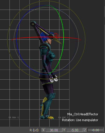

  8. Go to frame 84 and do the following:
    • Set the XYZ Rotation values to 30 (in X), -5 (in Y), and 0 (in Z).
    • In the Viewer window, double-click on an empty area to deselect the Head effector.
