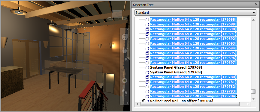

    Search for Objects that Use a Material
    1. Click Render tab > System panel > Autodesk Rendering .
    2. On the Materials tab > Document Materials panel, right-click a material and click Select Objects Applied To.
      Objects that use the material are highlighted in the Scene View and in the Selection Tree.
